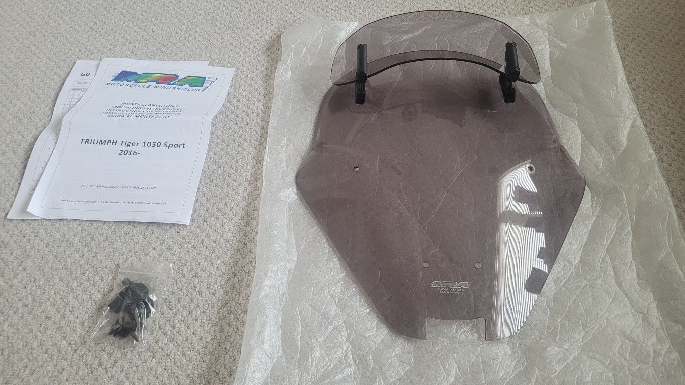

For UK Sale - Smoked MRA Vario Touring screen for 2016 Tiger Sport.
Details here;
https://www.bikehps.com/acatalog/Triumph_Tiger_1050_Sport_2016_onwards_MRA_Adjustable_Motorcycle_Touring_Screens.html?gad_source=1&gclid=CjwKCAiApaarBhB7EiwAYiMwqmTi2q_wVfwR-SbHAwvoSUPAd5DX38NLJOpOhEeu5hv_5H0gLUpKUhoCFNQQAvD_BwE#aCOL63948
This is in very good condition, I managed to find a couple of marks which bizarrely are in the inside, but other than that it's unmarked.
£60 posted within the UK
