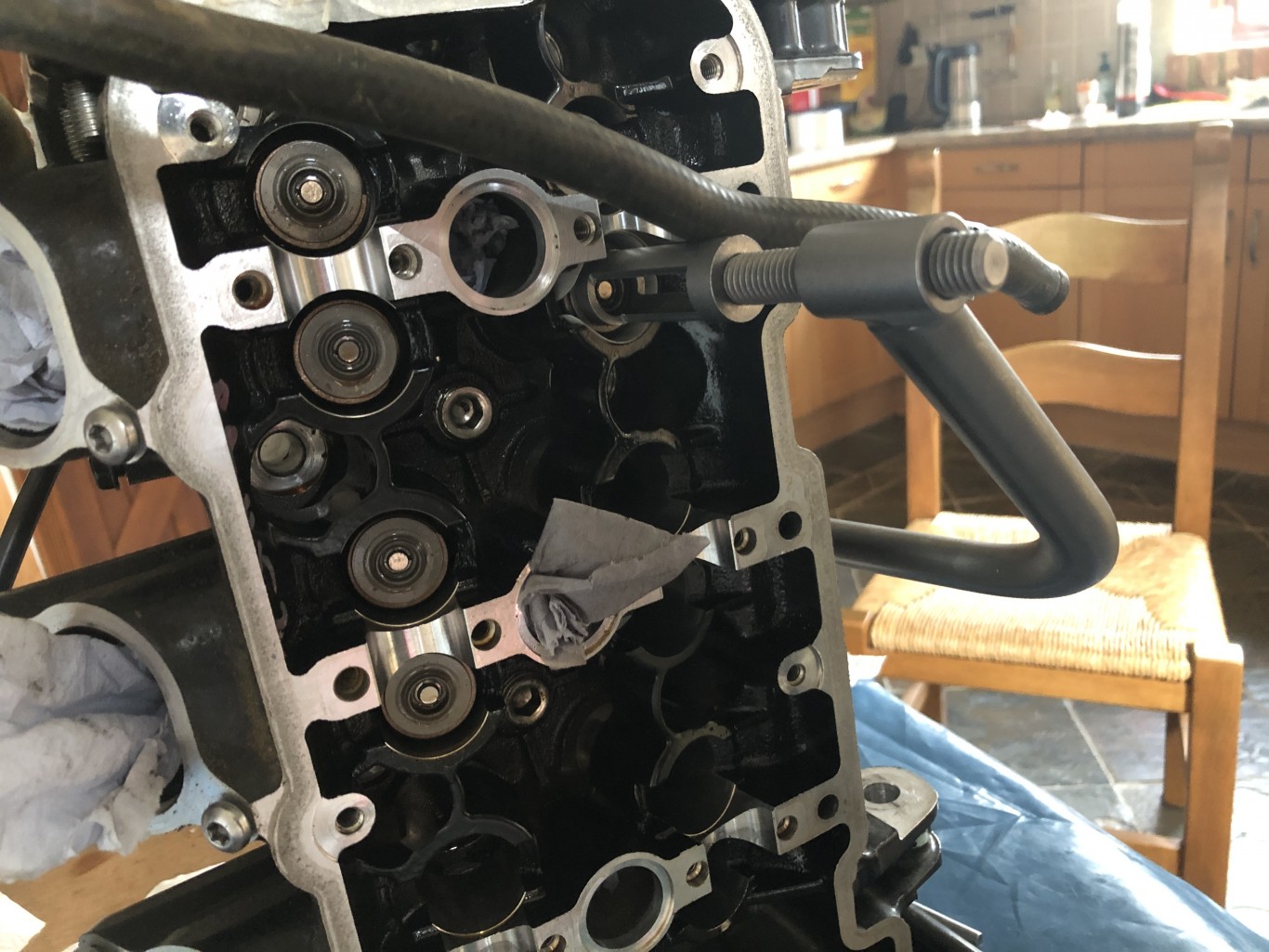

    My drain plug tool arrived this morning and I have ordered some threaded rod and a few nuts etc in order to convert it into a liner puller and so hopefully, I will be ready to remove the pistons by the weekend.
    Meanwhile, I spent my downtime removing all the valves, bagging them up and am now applying some elbow grease into cleaning the carbon off the cylinder heads before lapping in the valves and pressure-testing the head.
    My cheapo Chinese valve compressor worked OK but I was very conscious that one slip could spell disaster. I lined the bucket cylinders with a mylar wrap to protect them and then one by one, gradually removed each valve.
    I was uncertain about whether or not to retain the existing valve stem seals as the bike hasn't been burning oil but there's always the small chance of having scagged one whilst removing the valves and for the sake of another £50, have decided to replace them all on reassembly.
    To a greater or lesser extent, all the exhaust valves had carbon deposits on the seats. . . . Courtesy of eBay, I have bought a "chemico" lapping set comprising a rubber sucker and some coarse and fine lapping paste. A quick check revealed this to be 80 grit and 220 grit. The seats look in pretty good order and with no obvious pitting and so I suspect even the 220 grit will be a little too coarse. I have since  found a supplier who will provide all grades up to 1200 grit. The provisional plan is to start off with 220 grit and thereafter, 400, then 600, and finally 1000 grit before leak-testing the head. I have a Baldrick plan for the latter which might prove interesting . . . . . . .
    Meanwhile, if the worst comes to the worst and the pistons are toast, I have decided to cough up the readies and rebuild the thing regardless of cost. I want to keep the bike and also . . . . I want to get to the bottom of the wretched slow crank - it's only money :012:
    Note the mylar sleeve inserted into the bucket cylinder to protect it. The tool slipped once or twice and so it served its purposed admirably. It's very important to spend time getting the tool on square, before tightening - both on the valve stem and the head of the valve itself . . . .
    This is around the other side . . on the valve head itself. Although not visible, I cut a 25mm rubber washer out of 2mm sheet and placed it between the tool and the valve head - helps protect the valve but more importantly, helps locate the tool and prevent it slipping off to one side
    To a greater or lesser extent, all the exhaust valve seats had a crud on them - I find it a little bizarre really - this stuff isn't baked on but is more loose and shale-like. . . much the same as the stuff on the piston crowns. I think I need to spend more time exploring the upper reaches of my tachometer!!!
    Nothing left to do for now except spend hours and hours and hours, converting this to . . .
    this . . . .
