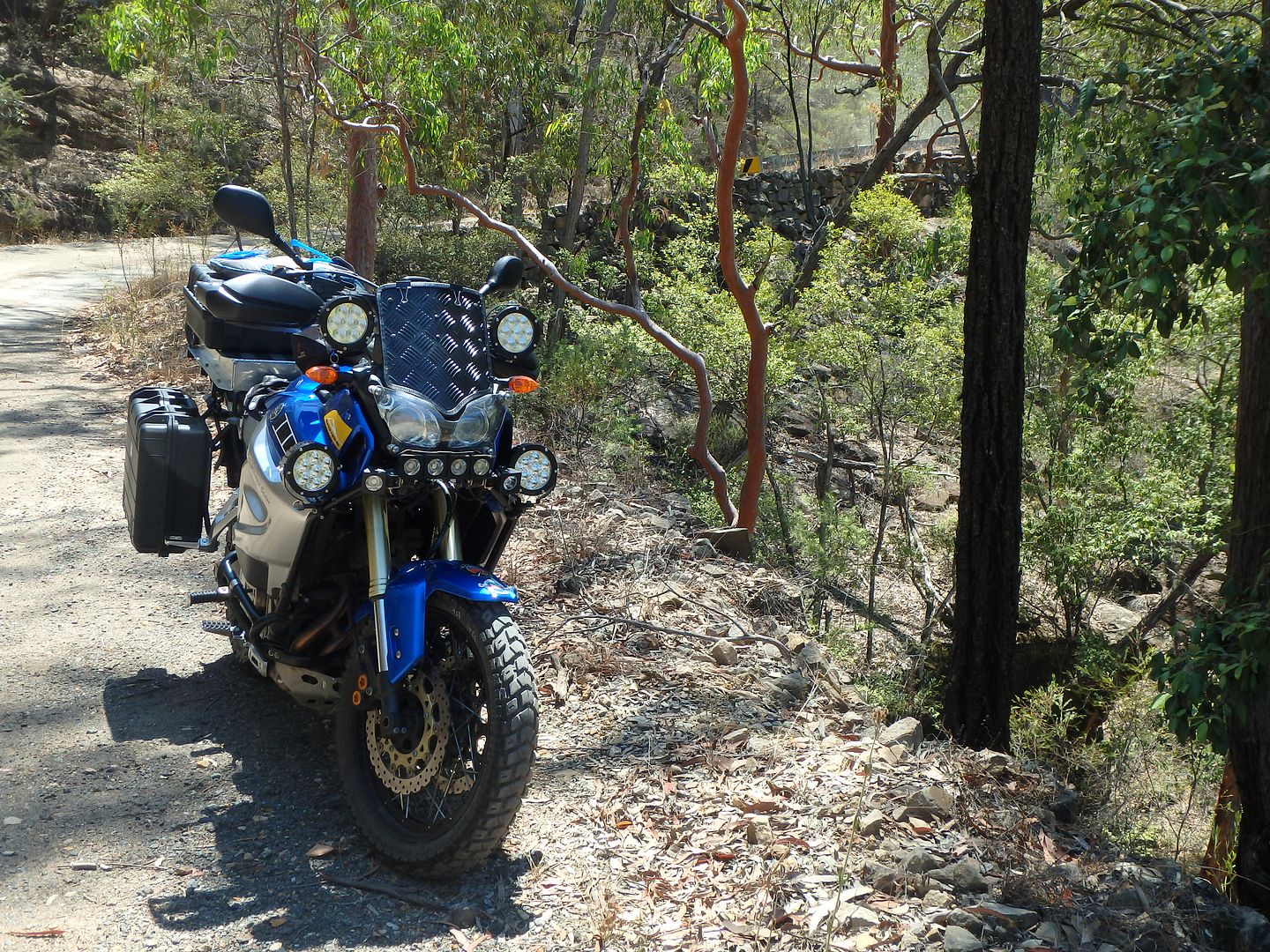

    If I could add a bit from experience regarding lights for seeing down the road at night - as opposed to being seen by anyone in the day - and only when there are no oncoming vehicles to daze:
    - mount them as high as you are able. That way, when aimed down the road the foreground is not the brightest part of the light's effective field. If you are peering into the distance for animals and pot holes and branches on the road, you do not want your pupils constricted by the close-up roadway;
    - avoid putting the lights on any part of the forks (or handlebars for that matter). As countersteering has the forks pointing the 'wrong' way during eg a left hand bend in the twisties your lights are pointed even more right than straight and definitely away from the apex. You now have brightly lit trees to the right and a black hole that you are riding into. Lights on the forks are good for car parks and UberEats delivery scooter riders;
    - round light patterns only, with no sharp cut-off. When on a straight road much of the light points upward into the trees (say 12 o'clock sector) but when tipped over in a right bend that 12 o'clock is now rotated to about 2 o'clock position and lights the road up around the bend;
    - Ideally if you spend a lot of time out of the city, consider multiple aux lights of various patterns to give an even and balanced light field;
    - if you don't ride at night, ignore the above.
