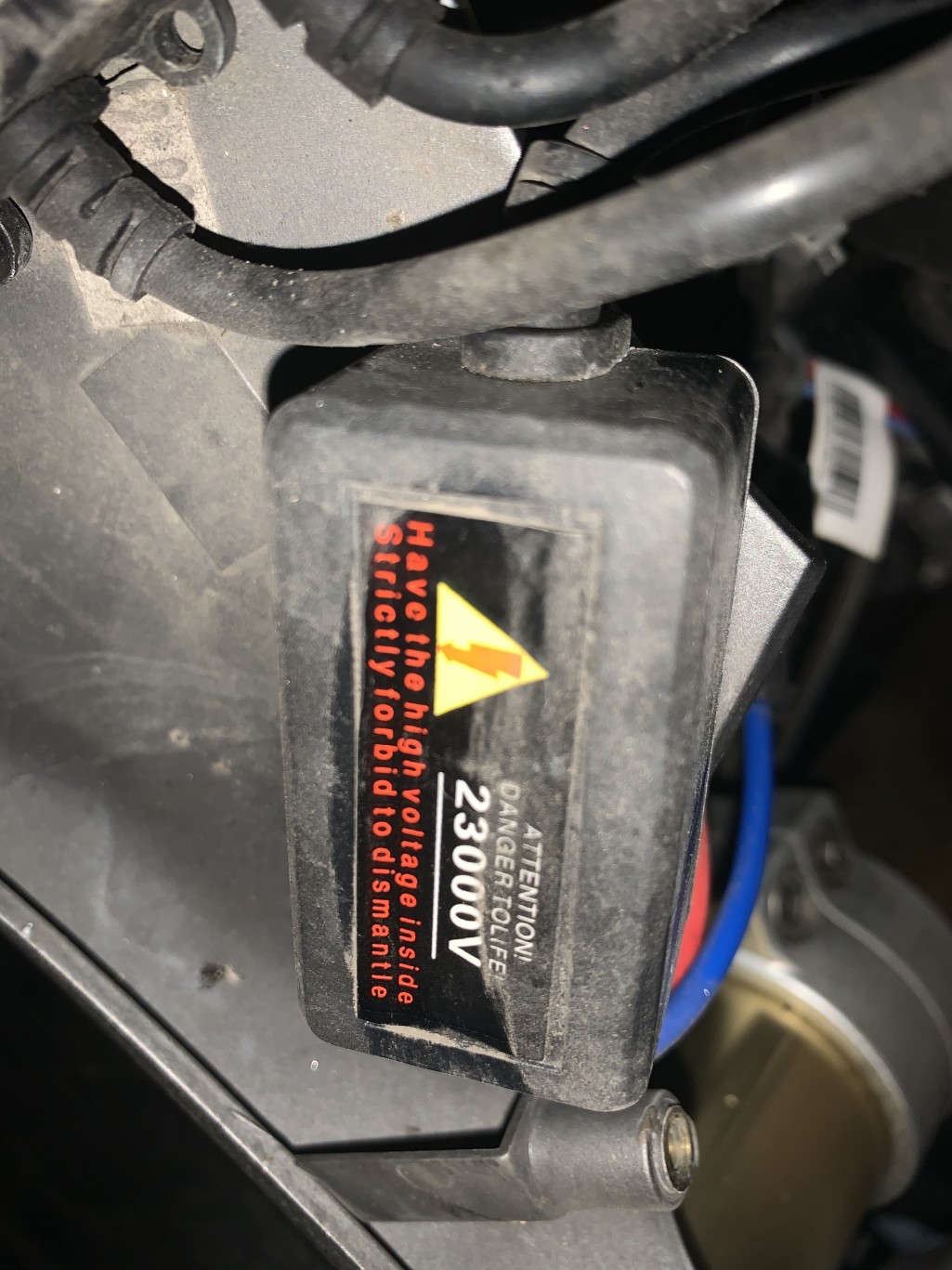

    Hi, My 2009 tiger is new to me so I'm just discovering some of the modifications that have been done. It looks like there has been a Xeon upgrade but only to the dipped beam. So when I switch on Full beam it is a yellow light and the dipped beam is white.
    This is a problem for me as I have ordered a kit the will allow be to have both lights on by turning the full beam down by 60%.
    So I need to upgrade the Full beam to match the dipped. How do I do that?
    Do I need another AC Digital Ballast and would I need to try and take the headlight apart or is it just a bulb change?
    There won’t be much room for another Ballast.
    Thanks

    I kinda feel sorry for you as it seems that someone did a projector light modification but only to one side of the headlight cluster. It means that they already broke open the enclosure and I wonder how hard it'll be to do so again. It is also the pre-Sport headlight solution which became a better option as a later upgrade and does not need the ballasts, etc. The yellow high beam sounds fishy as it should be a regular halogen bulb. I never bought into tearing the headlight apart so tried dual H4's before sucking it up and buying a Sport unit. Best money I ever spent. Yes, it takes some fettling, but its eminently doable and a much more elegant, and permanent, fix.
    Have you ordered a Twinlight module? I don't think it can handle a projector setup, but others will know better. Hopefully a guru or two chimes in... :-)

    Looks like you've got the same setup as I have in my '12 SE, HID low beam, halogen high beam.
    So, two things:
    Firstly, you don't need the Twinlight system, the HID globe will give you all the light you need on low beam, a reduced high beam will not help low beam light at all.
    Secondly, you can get "whiter" halogen high beam globes which just slot right in. This is what I did. Unfortunately I did this quite a while ago and I don't remember exactly which globe I used. Just go to an auto parts store and browse the racks.

    FWIW, my '07 had LED's in place of the stock H7/H9. Coming back from a flat track race at night I was terrified. No real light being thrown on the road. I had to follow close behind my buddy on his Road King. A sphincter tightening experience as he was running 75-80 mph. Turns out to get the LED's to put out any light the bulbs had to be pulled almost out of the housings. Threw them away and put in high end H7/H9's from Dan Stern (an auto lighting guru). Not a hell of a lot better. As we all know the OE reflector is junk. So...you either buy a Sport headlight assembly ($400?) or hang some lights.
    The bike is dangerous as built by Triumph.
    Meet my new Rigid LED spots.
