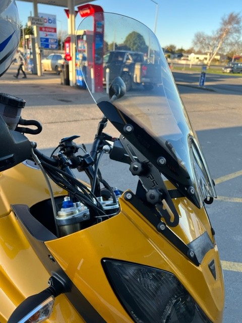

    Like a lot of other Tiger owners; I have noticed the helmet buffeting and had tried to cure it with a screen extension, but I was not totally satisfied with the results.
    I ordered the PP Screen Adaptor and it arrived last week - quite quickly considering I'm at the other end of the planet from them.
    I finally got out for a ride on Saturday and I've got to say that for me it's money well invested.
    After multiple adjustments I found a setting that has 95% of the buffeting gone and minimal wind noise.
    Am I pleased I bought it - Yes
    Has it completely fixed the buffeting - No
    Would I recommend it - Yes

    Had the Palmer bracket on my 2009 SE with a GIVI screen and selfmade airfoils/deflectors. These are now OEM on the last series Tiger Sport 1050  :164:
