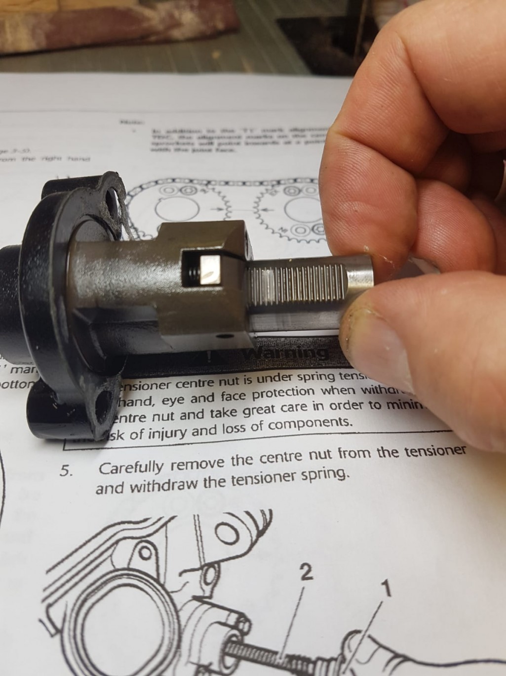

Offline apw99
  • Posts: 87
  • Bike/Model: Tiger Sport, TTR250
Re: Triumph Rattling Alternator
Reply #13 on: 10 October, 2021, 09:53:43 PM
Hi Sidewinder, can you explain to me exactly what those measurements mean?
I have so far pulled the covers on the starter and sprag, I had suspected the noise was a sprag 'catching' but it all looked fine. Then I pulled the clutch cover, noticed the center bearing is very notchy but when I removed the centre plate the bearing feels fine so I think it just does this when the shaft is pressuring the bearing, has anyone else ever noticed this?
https://youtube.com/shorts/sGtnpAZUmhA?feature=share
Next I pulled the cam cover, checked the chain guides, all look okay. Checked the shim clearance as I was in there, all were perfect. Pulled the tensioner and it seems to have a little wear
So I'm wondering if this tensioner is slipping from tome to time and causing the mechanical catching sound - any thoughts anyone?
From a side-view I could see that the teeth were all still intact on the tensioner shaft.
#14
Online Sidewinder
  • Posts: 795
  • Bike/Model: 2007 Tiger 1050 Yellow
  • City / Town: Sheffield
Reply #14 on: 10 October, 2021, 10:05:10 PM
They are to give an indication of how much travel is left on the tensioner tongue, this in turn tells you wether the cam chain is still being held in tension by it and how much adjustment is left.  Can be done without removing the tensioner itself as doing so can potentially cause the chain to lose position on the cogs and put the timing put and also not be seated on the guide blade properly.  If you've taken all the covers off anyway this is not such an issue as you can see what's going on and if timing is ok etc.
The measurements i quoted represent he extremes of the tongue's movement from fully in to fully out.   Given you've removed the unit, you should be able to easily see if it has any adjustment left ie could the tongue be pulled out any further?
