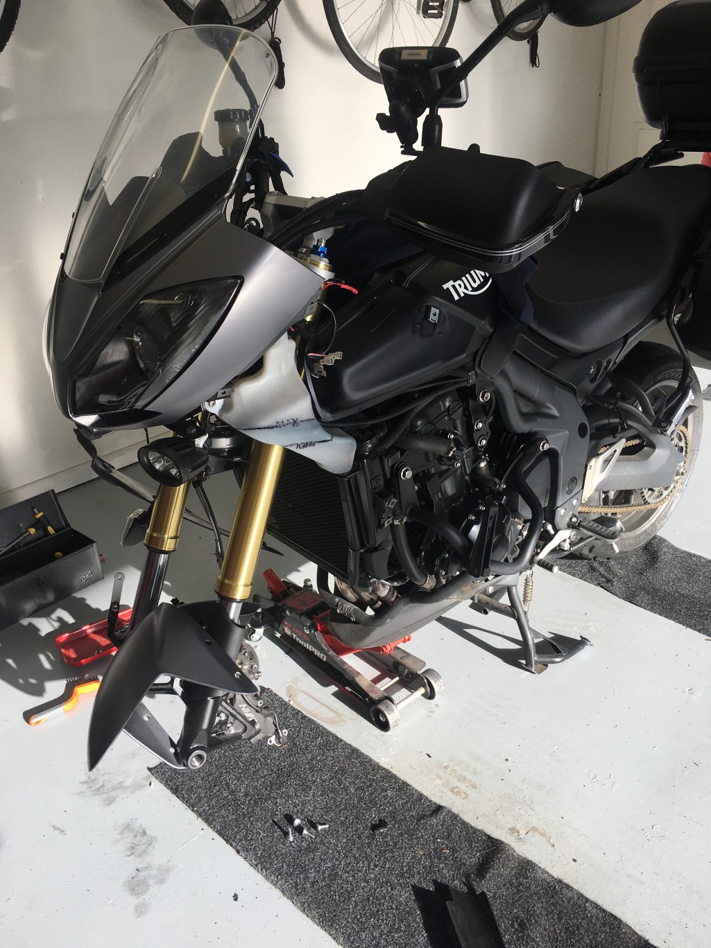

Just replaced front OEM Fork springs with Hyperpro
Progressive springs
went for a 20 min test ride
The front feels a bit lighter than before and easier to steer.. I think
the rate of suspension is certainly progressive in its action, meaning,  as i apply front brake, the first section of compression is soft but it quickly stiffens up, as the forks compress further
It is different than the oem...
I have all the Fork settings exactly as Per hyperpro specifications, but I will now need to fine tune it in to my liking

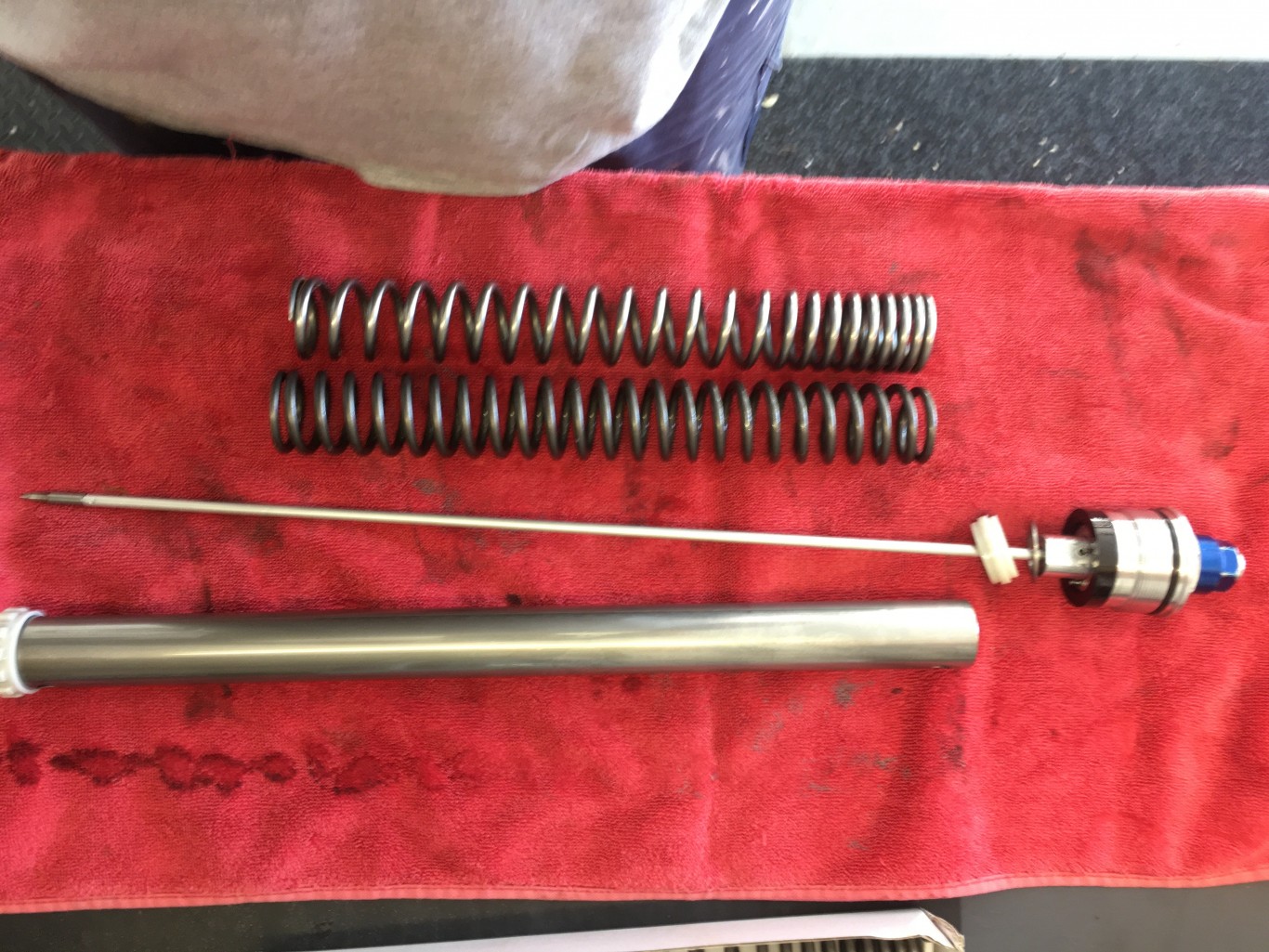

Overall Im happy I did this, just for the fact that the oil was grey, foul and I cant believe how thin It was, almost like water!
I replaced my fork oil 2 years ago with Castrol 10w, it was thick honey color When new.
Now motorex 15w
just demonstrates how oils break up and dont last a long time.
The manual calls for a 4 yr (!) fork oil replacement, but i will do this every yr from now on

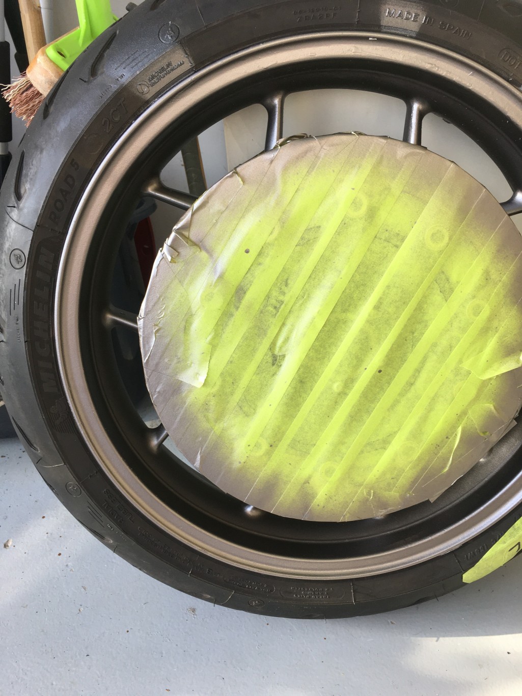

I also re sprayed my front wheel with plasti-dip And cleaned the brake pads and caliper pistons
..a 4.5 hr job

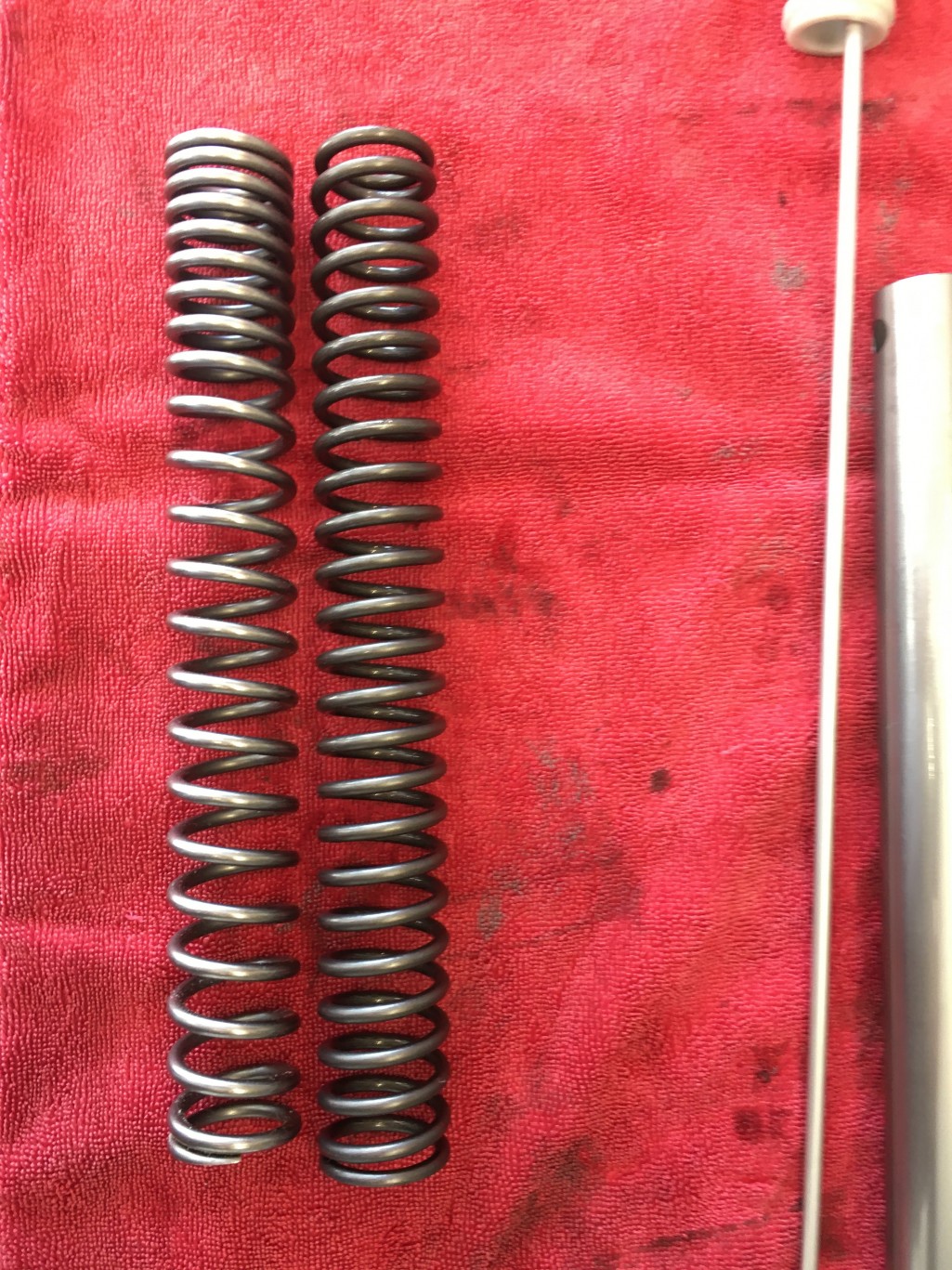

The Hyperpro progressive spring is the one with tight coils at one end...
