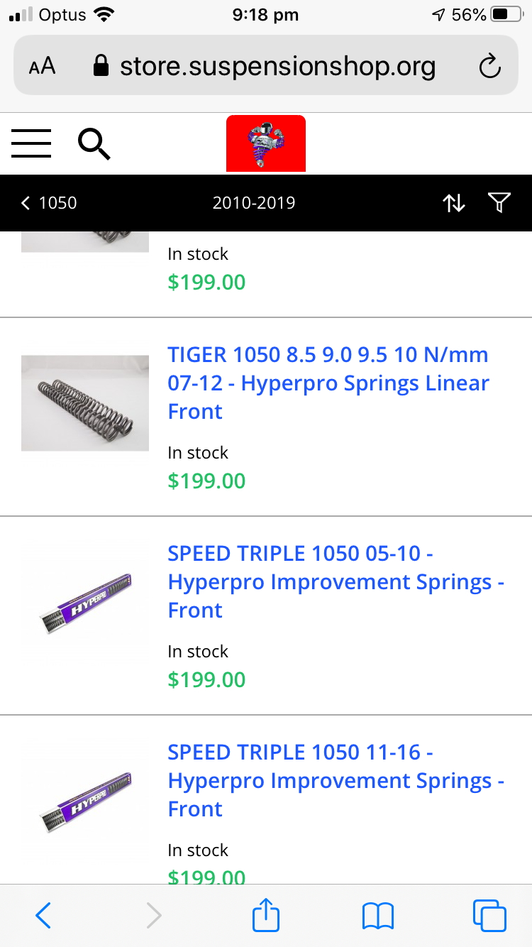

I am considering purchasing A set of:
hyperpro front springs for my 2012 1050se
wanted to ask you how they compare to stock?
I find the bike wallows in fast Downhill turns And is not a plush ride up front Generally
I weigh 95 kg
Mostly Twisty, touring type riding at brisk Pace
New Michelin pilot 5
No pillion
Stock suspension With Front compression Nearly maxed out
Thanks in advance

Looking back I have to agree really having bought your spare set Sean.  I did speak to Hyperpro about their springs and the guy seriously dissuaded me from going with Linear for a road bike?
