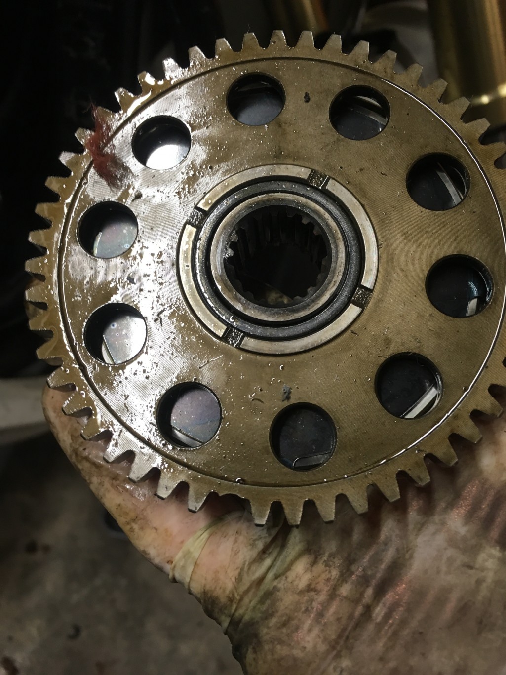

« Reply #26 on: 24 January, 2020, 08:36:54 PM »
Thanks all now for the update managed to get a second hand kit for my bike at 80 pounds
Checked to mine and they are actually the same so not sure if its the later one or not
Took cover off which was a pain as my crash bars were in the way and the nuts were buried in the bike
Made sure I know where everything was
Biggest issue was cleaning the old gasket off really and getting the big cover off
Layed everything out including washers to make sure all ok
Replaced all cogs just in case of small differences
Sprag clutch look good ? Lol
Can anyone tell me if I have upgraded battery cables or not ?
Gaskets were pricy and I didnt actually need to drop the oil doing it on the side stand
Total cost about 110 seems to fire up lovely Im definitely keeping the optimate on in case lol
  • Posts: 1588
Re: Starting issues
« Reply #27 on: 24 January, 2020, 09:45:25 PM »
Oops good job you changed your sprag Monty, got it done quite cheap by the sound of it.  :046:
Dont think you have the battery cable upgrade, the heavy duty ones are twice the diameter like these.
Got mine off ebay a while ago but I think most get them from the Facebook group, bloke called Jeff pudding halford I think.  :187:
