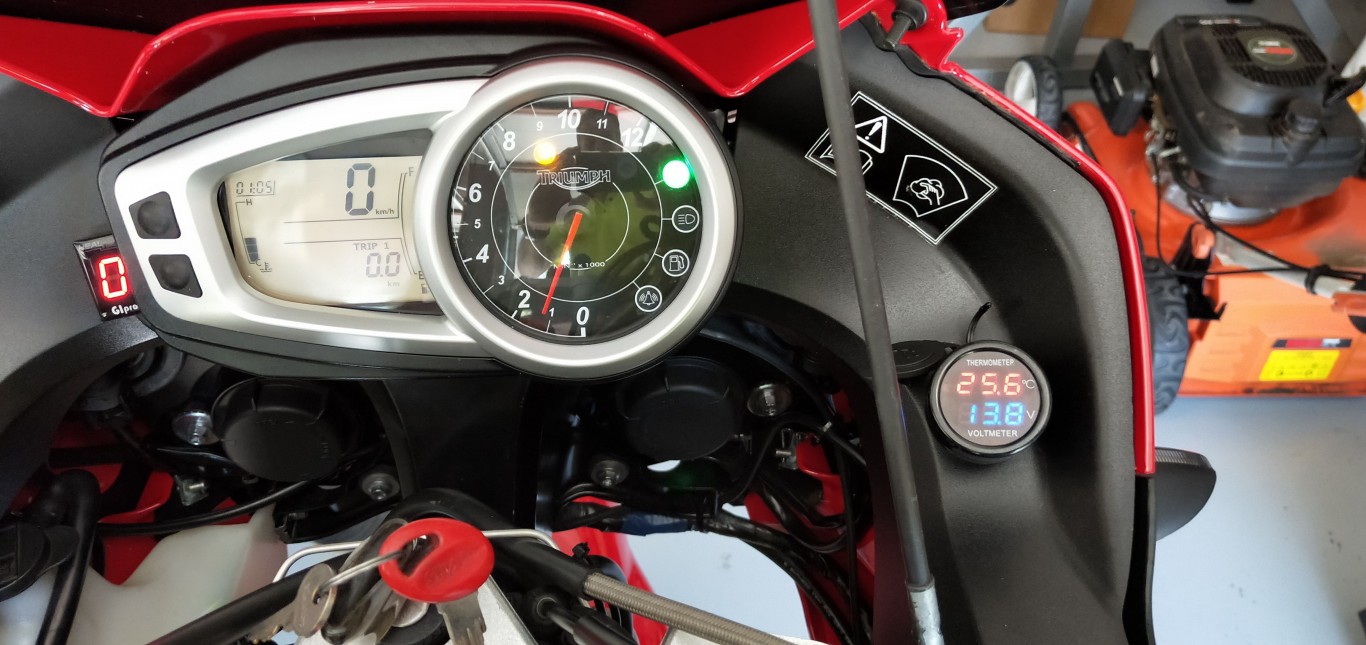

Back to the topic, what a difference a good battery makes (as everyone on here has been saying since forever).  I got a like for like replacement with a 14 series SSB Powersport, but at idle I now get 13.8-13.9v instead of the usual 13.6v.  And the battery holds 12.8V, which the old one never did - I never saw above 12.6v on the old one, which leads me to believe it wasn't quite right from the start.  I always had to have it on the charger the night before a ride to make sure it would start.  I got the old battery load tested and it showed 220 CCA with the label saying 340 CCA.  The guy said it should be alright, but I told him it was 2 years old and couldn't crank the bike fast enough when fully charged and he said "oh yeah, time for a new one".

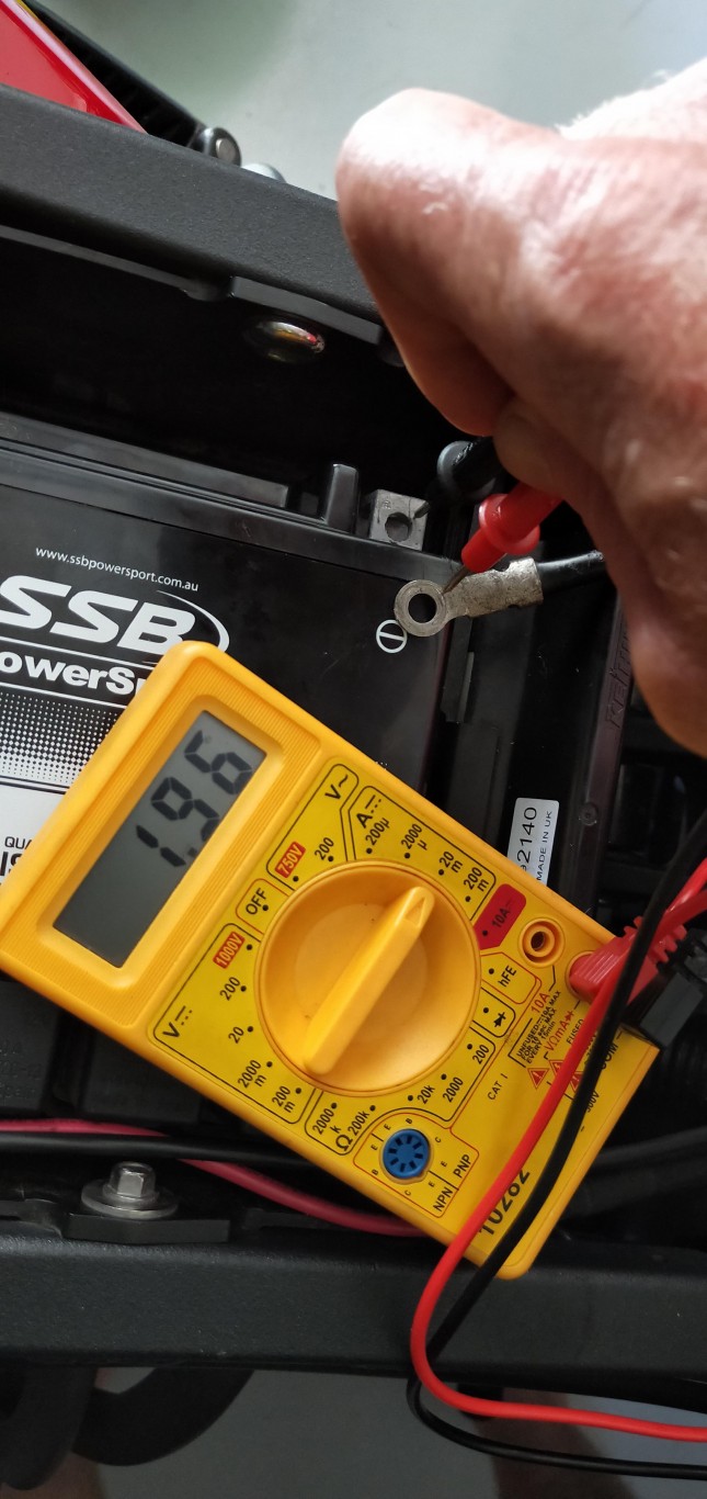

Just on testing parasitic current draw, can someone let me know if this is what I'm supposed to be doing?  The +ve cable is connected to the +ve terminal.  Does this look right?  I saw 2mA, so I think this is right.
Voltmeter at idle - everything is better with a new battery  :001:

Yep, thats right mate, and 2mA is pretty good
