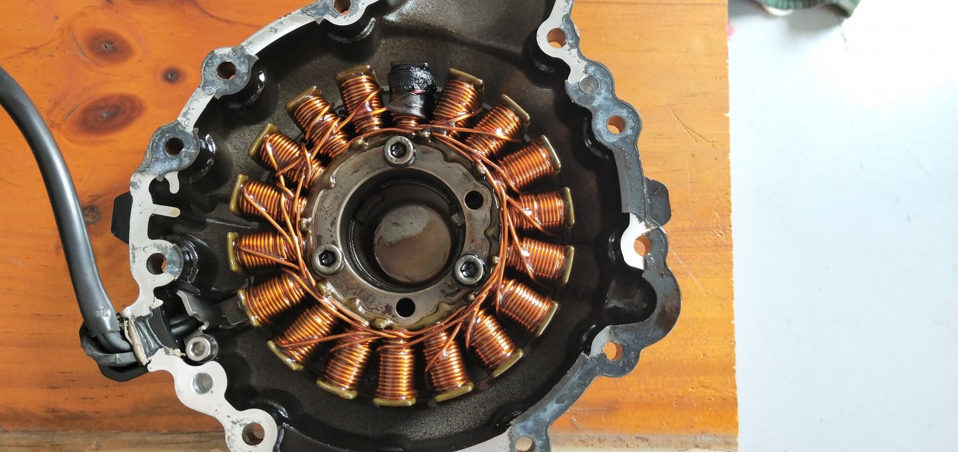

OEM Stator has only one of the spiral-wire-thingy's burnt:

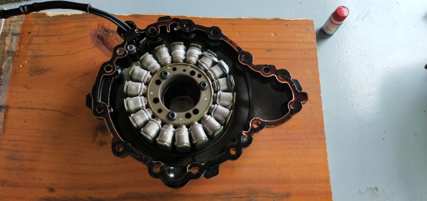

The new after market stator from Ricks (with the low profile cup-head bolts supplied, to prevent fouling on the rotor)

The coil failure at 9 O'clock position (from outside) is fairly common
Any reason for that? I know nowt, never had one go....now what'll happen.
  • Posts: 2677
  • Bike/Model: 2016 TS Matt Black
Re: So much for the series R/R theory
« Reply #5 on: 23 December, 2018, 04:18:22 PM »
*Originally Posted by Paul2bikes [+]
The theory is that at that position it gets less cooling, not sure of reason though
2016 Tiger Sport, Power Commander, DNA, Wilbers Suspension, Healtech Q/S
  • Posts: 852
« Reply #6 on: 23 December, 2018, 04:32:59 PM »
Mine went in a slightly different position recently, was advised by the god folks on here that its because the oil feed into the left side of the engine was lower down so not as much oil higher up to cool the entire stator
Hmmm, odd being at 9 0'clock innit. I wonder if it's owt to do with oil level being at that point.
Edit
Just seen Tigemike's post above, likely to do with oil level then innit.

*Originally Posted by Tigermike [+]
https://cdn.img.tiger-sport.com/20181117_143517.jpg
Was advised that it was my R\R so changed that first for an electrex one   :157:
This was my replacement
https://cdn.img.tiger-sport.com/20181117_161018.jpg
Yep, top or 9 O'clock seems to be the usual places. Original oil feed came straight through the Crank bolt, its now higher up to help
