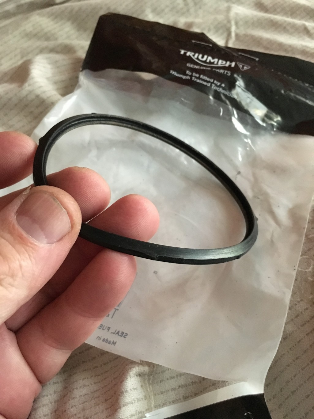

« Reply #14 on: 24 December, 2018, 03:40:41 AM »
O ring for fuel pump part number
T2401887
$12 aud

*Originally Posted by Zevk [+]
Thanks for the related fix and link
Would u or anyone know the part number for the large fuel pump o ring required when removing the fuel pump?  Has anyone reused the o ring with no fuel leaks ....?
I reused mine, but my bike is a lot newer. I would recommend you get a new seal just in case, last thing you want is to find your seal has distorted and wont go back straight

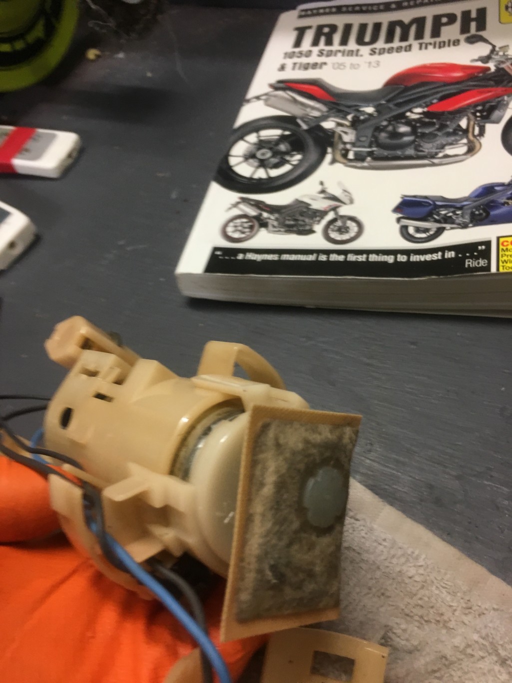

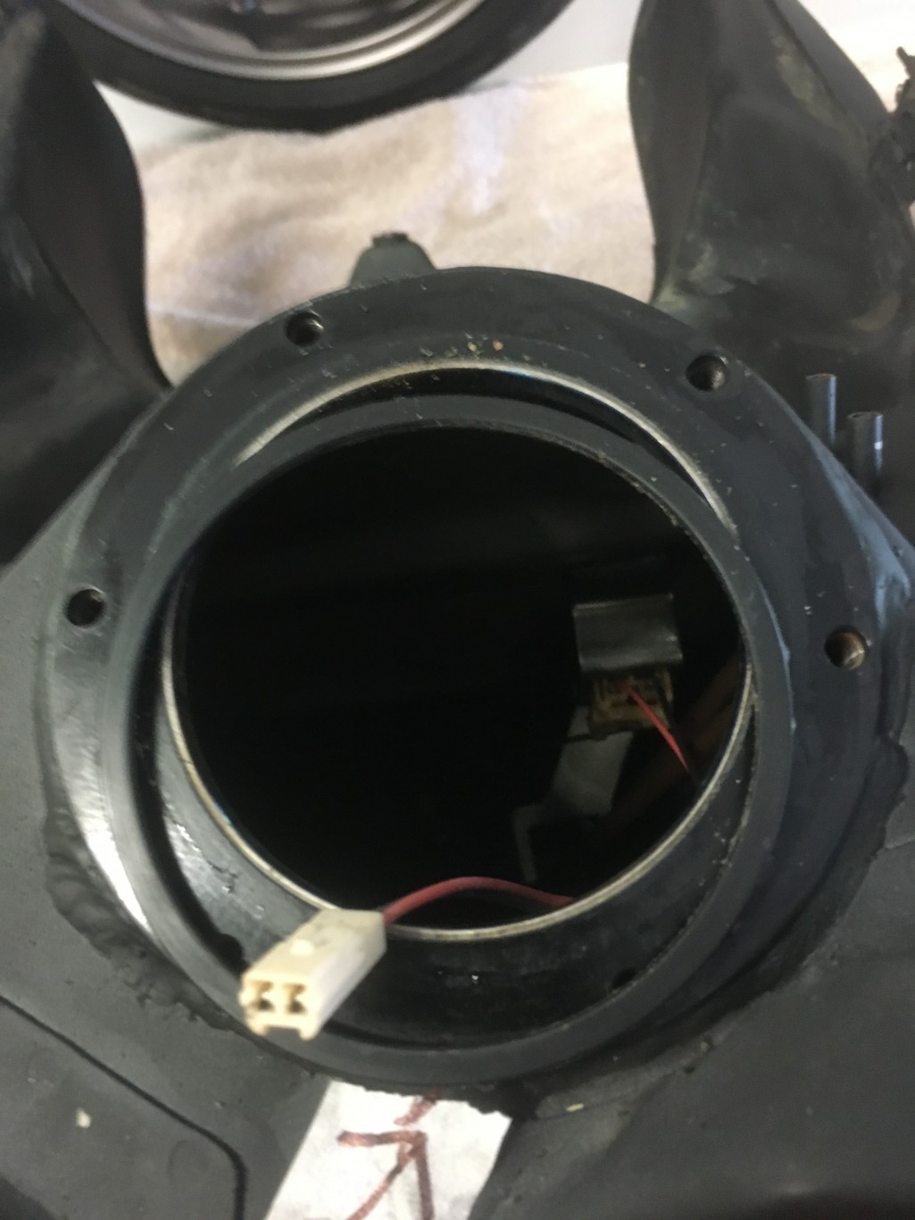

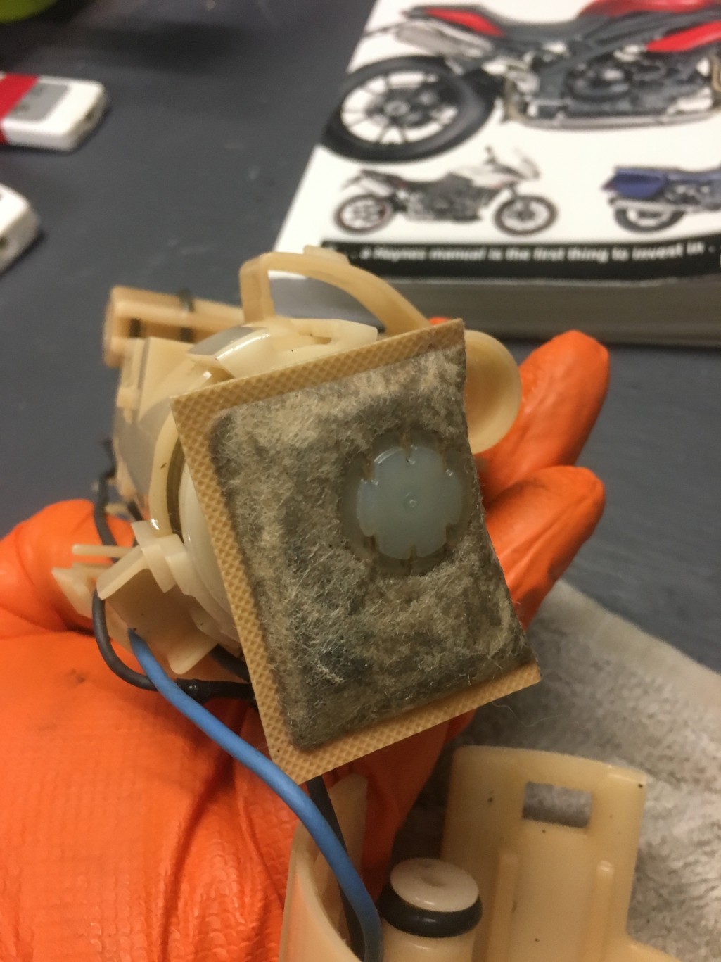

In effort to have a more accurate fuel gauge...
today I took the fuel pump out and cleaned the filter
It was a bit cruddy, but cleaned up easily with brake cleaner and petrol
I also replaced the pump gasket
flat side of gasket facing away and outwards from the fuel tank
Also added the zip tie as per the triumph update bulletin (thanks timbox!)
Although no mention of this in the workshop book, I added blue picture to the fuel pump torx bolts as this is something you really do not want to get loose!!

  • Posts: 5532
Re: Fuel gauge inaccuracy and remedies...?
« Reply #18 on: 27 December, 2018, 09:05:07 AM »
Is that teabag thing the filter?
On the ST955i the fuel filter was a 12k mile service replacement. It was a proper filter.
Like this one:
https://www.squaredeals-ltd.co.uk/mahle-fuel-filter-kl145-metal-cased-replaces-triumph-part-t1240850-825-p.asp
  • Posts: 130
« Reply #19 on: 27 December, 2018, 09:13:28 AM »
Yes the tea bag is the filter and as far as I am aware can only be replaced if u replace the complete fuel pump as a unit, not sold separately
