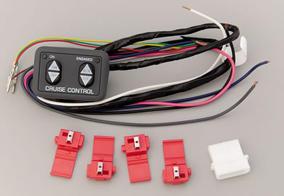

Switch kit.$41.95
Cruise Control, Universal, Electronic, Kit
Summit Racing Rostra Global Cruise Control Kits
